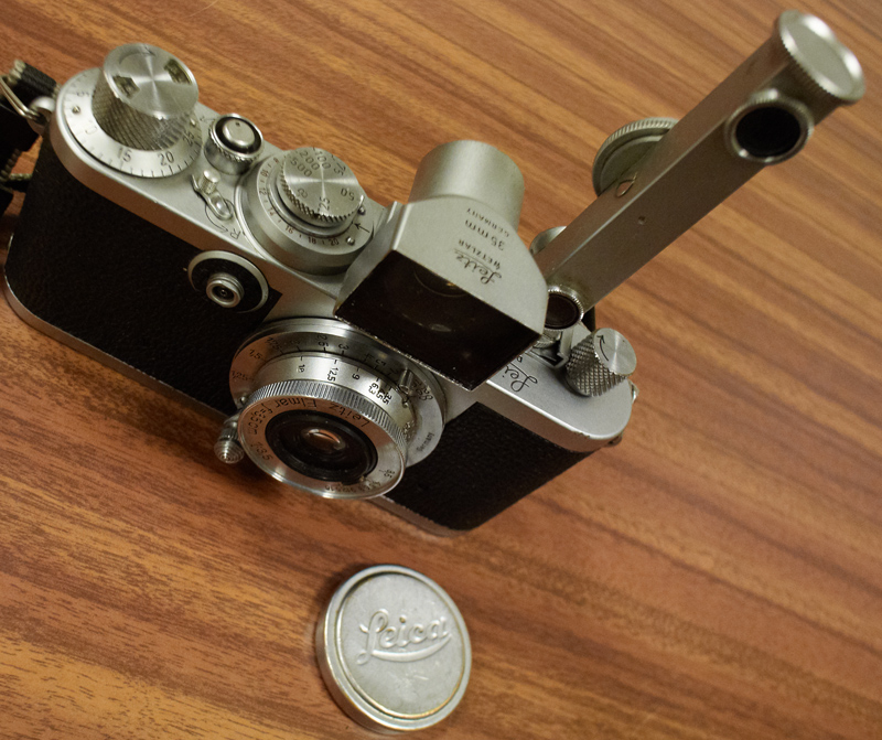

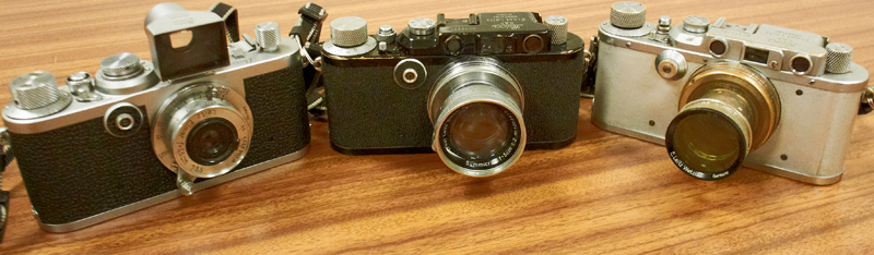

vu ici
Messages : 10588
:wink: Taille ?
https://www.summilux.net/forums/viewtop ... 26&t=33449
